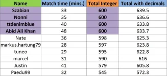

So who won?

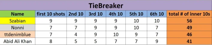

And with the TieBreaker we have the following top 3

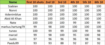

Here is a 10-shot breakdown:

Some excellent groups, particularly from the top 4.
Interesting to see that the person who had by far the best hold stability (aiming trace speed in the last 250ms), Paedu99, had a dreadful group with vertical stringing. The lateral group was fine (bull width), but vertically shots ranged from high 7s to a low 6. Does anyone have any explanation for what Paedu99's problem might be?
It is difficult to diagnose without seeing the individual shot traces, but it almost looks as if Paedu99 was using a blade foresight and getting inconsistent gaps below the aiming mark. Another possibility is variable head position on the cheekpiece, so that they are not looking through the middle of the rearsight, but sometimes a bit low and sometimes a bit high. One other possibility is that the aim is not taken at the naturally exhaled state. If the Natural Point of Aim is high, and Paedu99 stops their exhalation part way through (when the aiming mark is in the middle of the foresight, rather than when naturally fully exhaled), that can introduce some vertical inconsistency, but I have never seen it quite as bad as this.
Can anyone help diagnose what Paedu99 is doing wrong. With such good hold stability, I would expect much higher scores and tighter groups.
